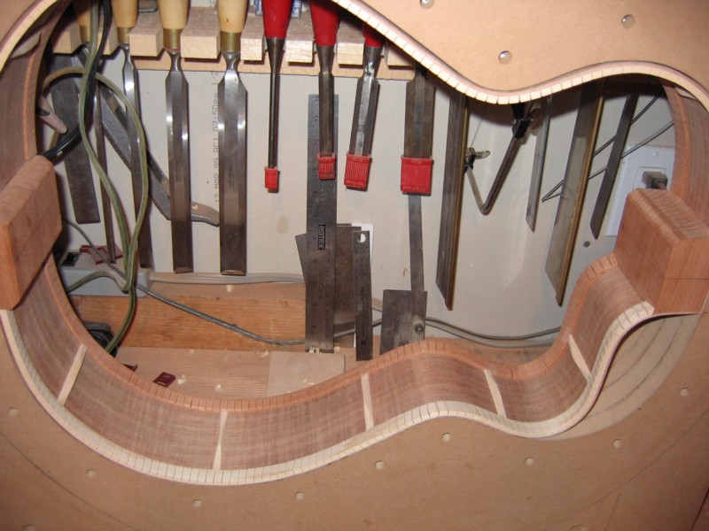

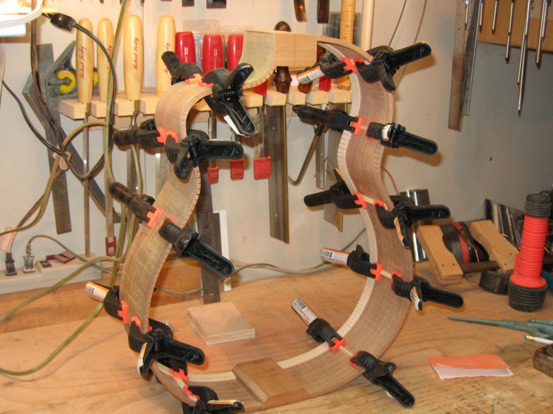

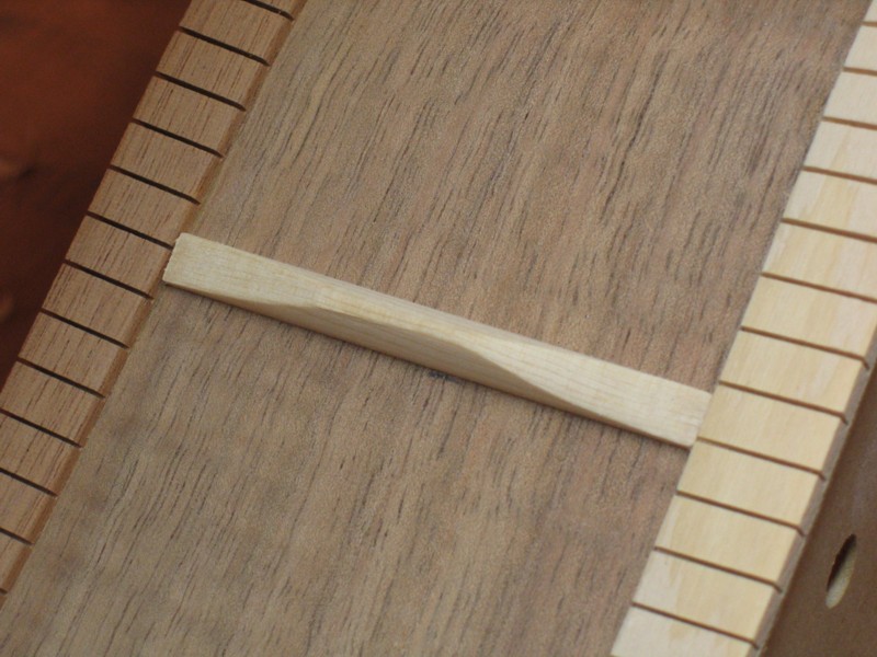

PostPosted: Fri Nov 25, 2005 11:42 am
Hi Hesh,
I have no experience with this as to the tone questions you were asking about but here is the current state of my first guitar.
This is the glue up of the finger braces. They started out as 1/4" by 1/4" pieces that I drew a center line down (roughly be free hand)and then I used a block plane to make them nearly triangular and sanded those pieces to 220 grit. They I used a fine saw and cut them to fit between the kerfing. The spacing is even on both sides but is somewhat random otherwise, just looked for the best spot. 5 on each side.
Here they are installed, with a 1" taper at each end of each brace into the kerfing height.
Here is a couple close-ups
I hope this helps. Others, like Mark Swanson, use bias tape (available from linen supply stores) and say that it is just as good and lighter. I am a wood guy so I like wood. These ones, of course, are spruce and are very light.

Mine looks exactly like Shane's except I only put three on each side. I used spruce and they're shaped just like Shane's.

Mine are like Shane's only with out the scallop. I just miter the ends. This is similar to the ones I have seen in Collins guitars. I use mahogany on EIR. I've even heard people say they have used popsicle sticks. What ever works for you. Some people even put in really fancy ones-inlaid and everything. Something is probably better then nothing though.
